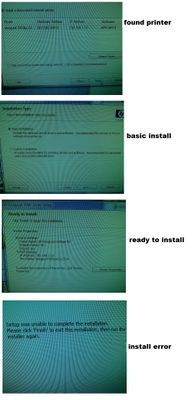

Cable came in and is installed
cable is CAT 6 Patch Cable, 4 Pair utp
ordered from ebay @ link below
I hope this is a correct cable to use
I did a reset of the I/O card to get new ip address
see images below to see whappened and in order of occurance
08-04-2017 07:44 AM
I am sorry but your screen shots for the install are to small to read. In any case you need to download the 32 bit driver from the hp web site. After you do this you run the program and when the box comes up with the path, change it to C:\5500 and click on unzip. Now on your computer you go to devices and printer and then click on add printer and then click on local printer and then click on create port and in the drop down choose standard tcp/ip and on the next page you type in the ip address of the printer and REMOVE the check mark from the query the printer and then choose next and when you get to the makers page you click on have disk and you navigate to the C:\5500 folder where you choose the inf file needed and continue to follow the instructions on the screen until finished.
