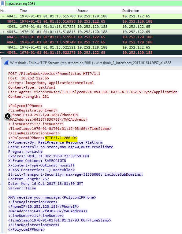

A firewall is blocking the Telephony Event Notification message send from the phone to the Clariti Manager / RPRM or the Phone State Polling from the Clariti Manager / RPRM to the Phone.
Non working example:
Working example:
Solution would be to check the firewall between the Phone and the RPRPM.
