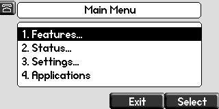

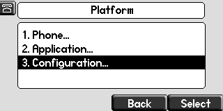

Using a newer Version like UC Software 3.3.x or later also offers the possibility to check the Provisioning Status via the Phones Gui.
Press Menu Key
Select Status
Select Platform
Select Configuration
The Phone will show the additionally loaded Configuration files in the Config Section
Scrolling down will show the amount of accepted or wrong Parameters
NOTE: The Menu depends on the UC Software Version running on the Phone and may look different on the multiple Hardware Platforms!

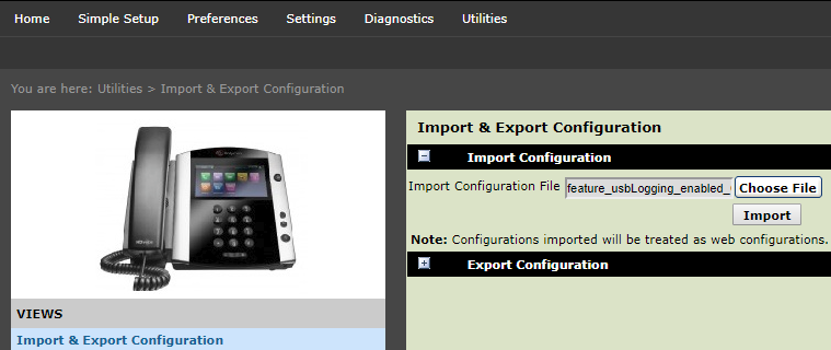

You can configure the USB Logging feature using the following parameter:
feature.usbLogging.enabled="1"
An example file to enable / disable this via the Web Interface => here <=. Simply download, Unzip and import
