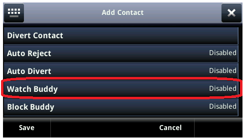

You can also add this via the Phone Directory itself once the presence parameter has been added.
Bove example shows the selection. To activate buddy watch for this contact change to Enabled.

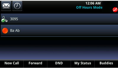

Idle monitored Extension:
Busy monitored Extension:
image image
