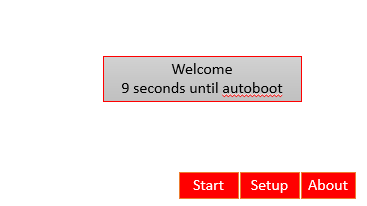

Simply restart the phone and then press:
  • Cancel
  • Select Setup
  • or simply Setup (depending on the software Version) and enter the Menu.
NOTE: The standard Password is 456 and more details can be found => here <=

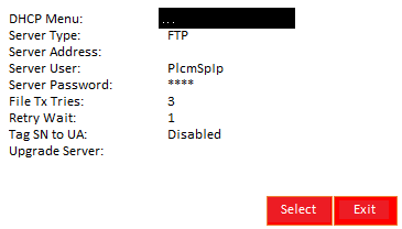

  • Select Provisioning Server
  • Modify the Server Type, Server Address, Server User and Server Password to suit your environment where you set up a Provisioning Server.
