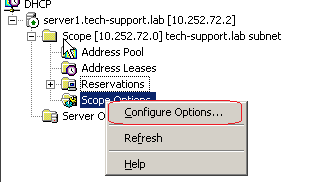

Step 1 Setting the VLAN Option via DHCP
Below example is from a Windows 2003 Server
Setting a predefined option:
imageimage  image
Above Example shows how one of the predefined Polycom options 144 is added to the DHCP server.
image image
The above example shows how the newly created predefined option is assigned to the scope with the data entry value as suggested in the admin guide.
VLAN 111 should be assigned via DHCP once the phone queries the Options.

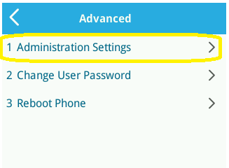

Step 2 Setting/Changing VLAN Options on the phone
  • Select the Menu Key
  • Select Settings
  • Select Advanced and add the Password (Standard would be 456)
  • Select Administrator Settings
  • Select Network Configuration
  • Select Ethernet Menu
  • Select VLAN Menu
The above example screen capture from a VVX500 shows the VLAN menu on a VVX500 within the Ethernet settings.
The same can be done using the Web Interface (UC Software 4.0.0 or later)
