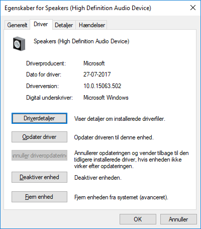

Hmm, I´m running Win10 build 1703 and i have no issues choosing the Microsoft OS build-in driver instead of the vender specific driver.

My problem seems to be the inverse of that described:  Windows is forcing me to run their driver (version 10.0.15063.502 dated 7/27/2017), and it still gives tinny sound. I note that when I click on Driver Details in the Speakers Properties dialog, I get a message saying "no driver files are required or have been loaded for this device", so I guess that this is truly baked into the OS.

SuperRobert; det ser godt nok Dansk ud! ... thanks for supplying the device driver snippets; my problem is that after a reboot the Conexant drivers are loaded back and sound is messed up. Only option to avoid that is to turn off online driver updates altogether for all drivers so I really don't want to do that. Do you have any other clues you can add please? ...  Mange tak! ..
Har du prøvet med "roll back" driver på enheden? Det har jeg gjort på en enkelt maskine og så blev jeg spurgt om hvorfor - og her valgte jeg fordi den "gamle" driver virkede bedre - alt den indbyggede native windows driver.
Have you tried the "roll back" driver on the device? I have done that on a single machine and I was asked why - and here I chose because the "old" driver worked better - all the native native windows operate.
Men ellers har det virket fint på 10 maskiner med at bruge Windows egen driver.
