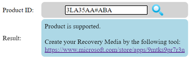

If your product ID is 3LA35AA#ABA then you COULD restore your HP system from the cloud
the tool: https://www.microsoft.com/store/apps/9mtks9pr7r3n
I have never done this but I understand it requires a 32gb USB flash drive
Instructions are here https://support.hp.com/us-en/document/ish_4511095-4511141-16
the above is ONLY a last resort. You must confirm that your system passes diagnostics and you should make an attempt to recover the existing operation system first, as explained earlier.

Please try that cloud recover tool for the 3LA35AA#ABA product code.
The 3LA35AA is listed as the product ID for your system as shown here. Expand "Product release information"
Even if 3LA35AA#ABA does not exactly match your system I suspect it is better than doing a windows 10 (or 11) reset as Microsoft's reset tools do not have access to specialized drivers that HP may have on your system.
I have never done this HP cloud restore. I have read that a 32gb flash is needed and the computer that you use to help create the recovery needs to be window 7 or later.

10-01-2022 05:39 AM - edited 10-01-2022 05:41 AM
From a discussion with the expert @Prométhée the "R" in 3LA35AAR#ABA possibly means refurbished or renewed as shown below from amazon vendor
When asking for cloud recovery use only 3LA35AA#ABA when asked for your product id
do not use the "R" one.
