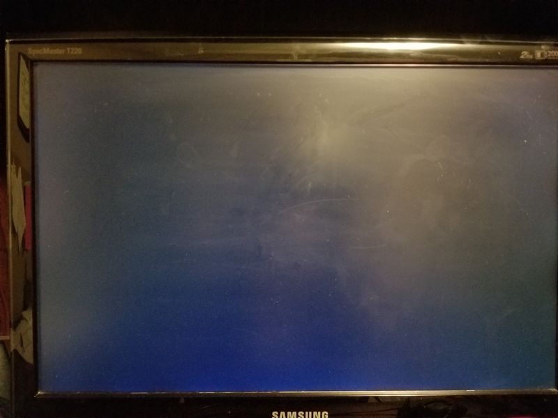

My HP PC has been freezing periodically, but now it's just plain not booting.  It seems to get past the BIOS load, but when it tries to start windows, it just gives a static screen (see pics).  Below is a walkthrough of when I try to start it...
I hit F1 once the HP logo appears, and get this
I hit ESC and go to the Startup Menu.  There, I select OS (there's no other viable option).  Then I get this screen...
Then I get the next two screens in succession...
After these screens, I get this one....
This static screen appears for about 5-10 seconds, afterwhich, the display shuts off and the PC sits there whirring.  Eventually, it tries to restart, but you just get the same screens.
Due to the PC freezing prior to it not booting, I thought the issue was a bad processor.  So, I bought a new, upgraded processor and installed it (which is why you see a 1700X processor).  It did not fix the issuse.  My only other thought is that the MB may be bad, but I'm not sure.
Any advice is appreciated.
