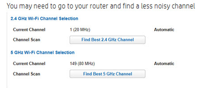

I am glad you got it working.  From your description the problem is the older WiFi card not being able to find a clear channel.
You might want to log into your modem and run the app (if any) that finds the best channel.  For example (AT&T modem):
