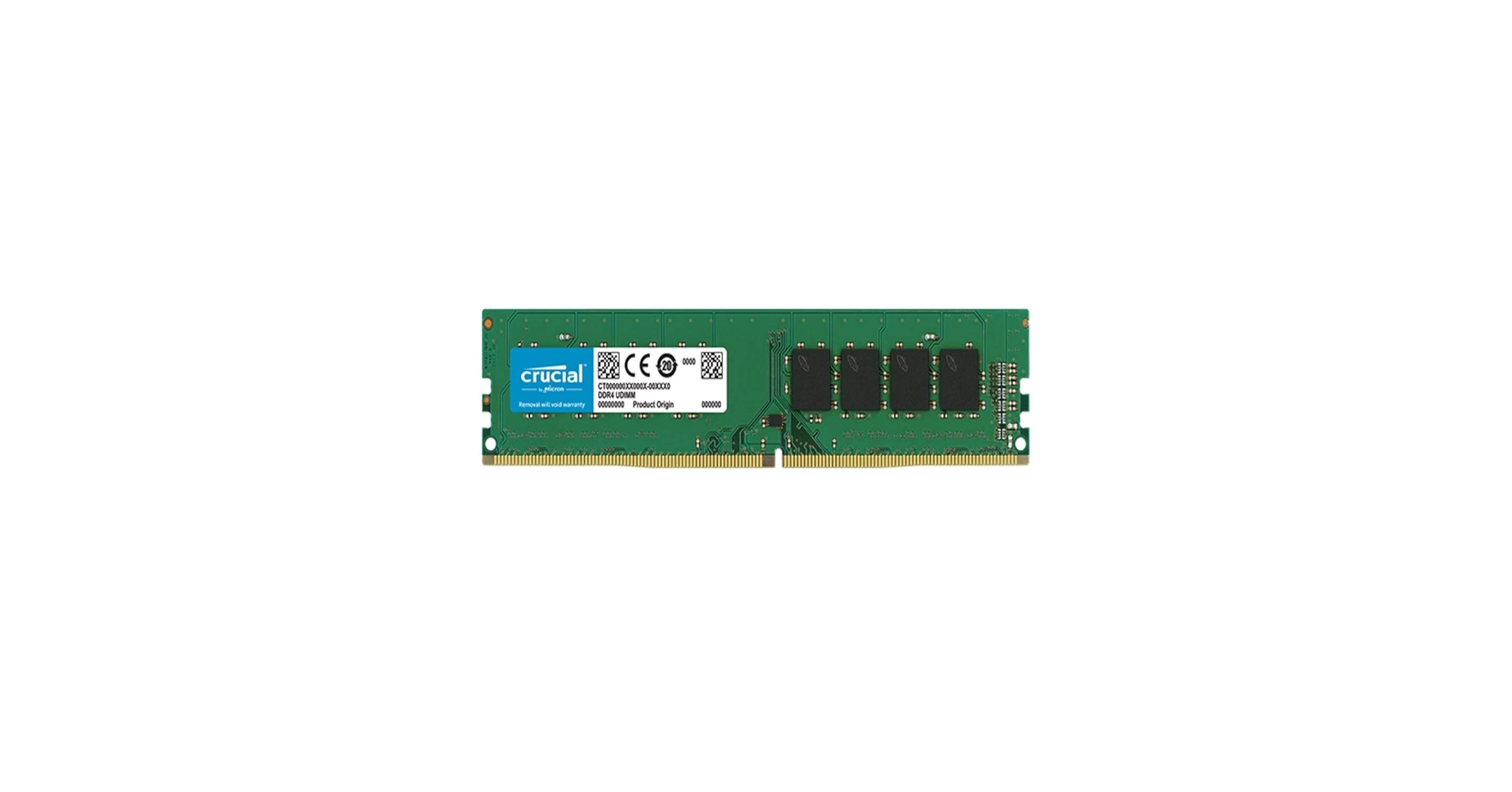

Have found this one: Crucial 16GB Single DDR4 2666 MT/s (PC4-21300) DR x8 DIMM 288-Pin Memory -
                                        CT16G4DFD8266
Am thinking to leave the present 8 GB in place, and dump the present 4 GB.
Would use the "old" 4 GB slot for this new single 16 GB Moule, (from Amazon) which would then give him 24 GB total.
Hopefully, he could then run the new MS Flight Sim., which will not run at all on his present 12 GB.
a.  Does the above make sense ?
b. Could you verify that the 16 Crucial module noted above will fit on his HP Pavilion Desktop ?
           (If not, might you select for me (Amazon, Crucial, PNY, etc.) a Single 16 GB one that would)

Yes, this 16 GB module is the one you want...CT16G4DFD8266
https://www.crucial.com/memory/ddr4/ct16g4dfd8266/ct12475838
...and yes, you can remove the 4 GB chip, add it to the 8 GB chip and have 24 GB of total memory running in single channel mode.
You could google the part number and see if you can get it for a little less on Amazon for example.
I see that Amazon sells the same part number for almost $13 less than buying direct from Crucial.
