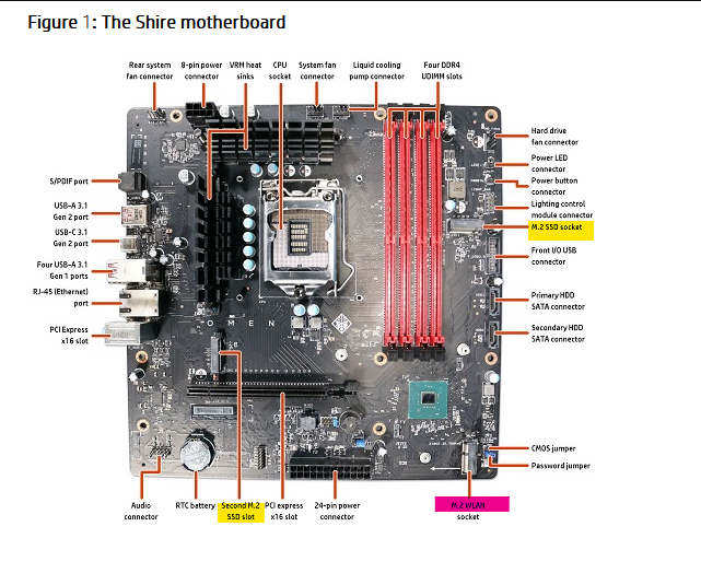

Looking at the product and motherboard specs at the link below, this is what I can determine...
OMEN by HP Obelisk Desktop PC - 875-1055xt Product Specifications | HP® Customer Support
The PC has one of the M.2 SSD slots occupied by the 256 GB NVMe boot drive.
There is a second M.2 slot for another NVMe drive.
If you look at the pretty unclear picture of the motherboard (I had to zoom it to 150%), you will see the second M.2 SSD slot, just above where the Nvidia graphics card is.
The Western Digital WD BLACK SN750 NVMe M.2 2280 SSD will fit in that slot.
The 3rd M.2 slot is only for the wifi adapter and is occupied.

be careful because it is mentioned:
Two M.2 socket 3, key M (one for SSD card PCIe x4)
this would imply that one is compatible pcie x4 , but maybe not the other:
You can try the crucial scan, the results are normally guaranteed for compatibility
Welcome to Crucial USA
that said, except for some type of use, there is little advantage of having a second M2 SSD!
It is especially useful for installing windows and some programs!
