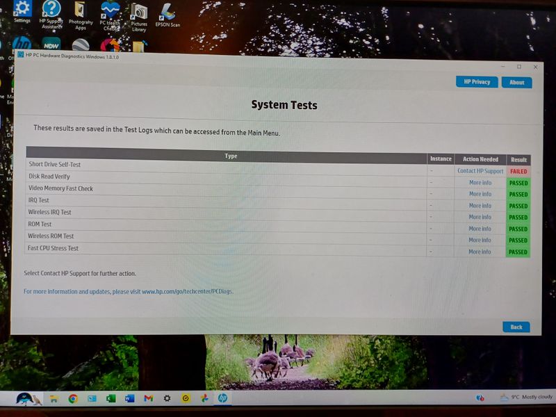

HP Diagnostics Short Test failed.
Failure ID | 90ACGJ-000C1F-XD4CQJ-60RQ13 | |

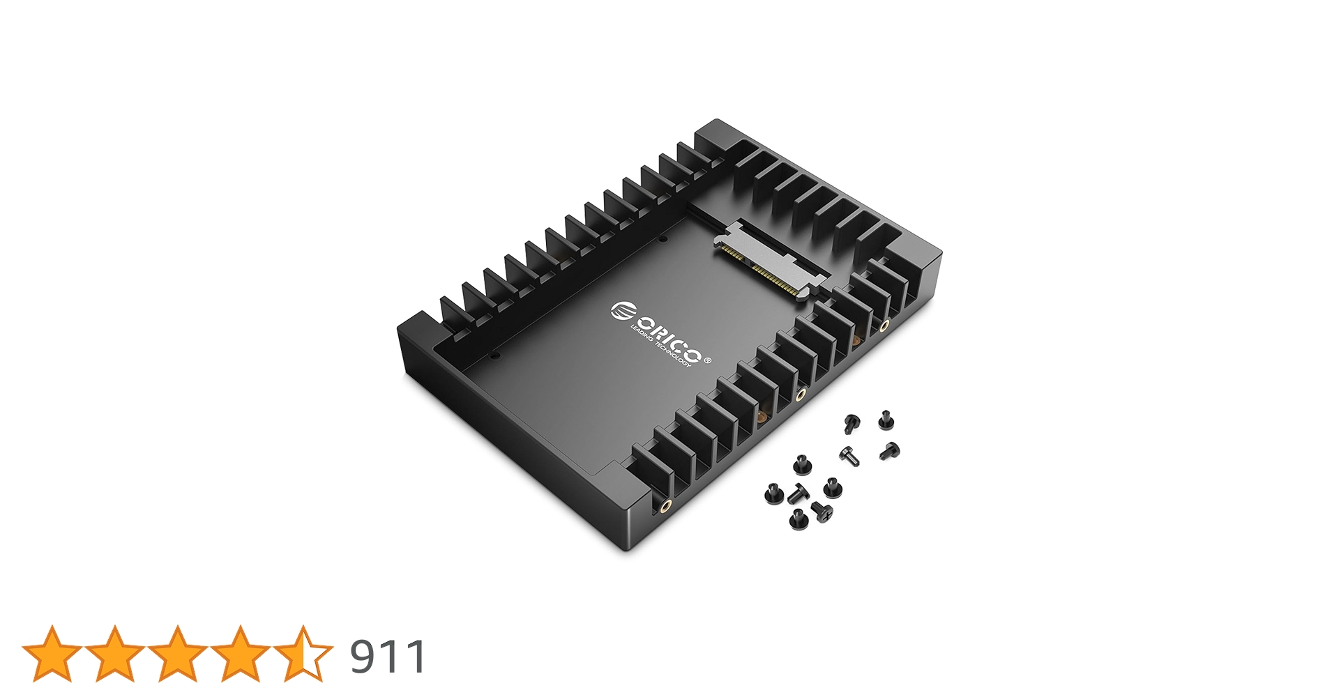

If you want to upgrade the drive to a 2 TB solid state drive (SSD), you will need a 3.5" to 2.5" adapter to fit the smaller 2.5" SSD where the 3.5" drive is now: The downside of this is the 2 TB SSD is somewhat costly.
I like this adapter because it is the size of a hard drive, fits where the hard drive goes, and the smaller 2.5" drive fits inside the adapter.

A few years back I replaced the 128 GB drive with 512 GB.
It looks to me that the 1.8 TB drive is faulty.
I have attached some photos of diagnosis reports. From the info. shown, can you confirm my thoughts please.
Currently there is no visual evidence of fault whilst operating the PC but presumably it could crash without any warning.

02-19-2024 06:46 AM
You're very welcome.
If you unplugged the 2 TB hard drive and the PC works fine and then you plug the 2 TB drive back in, then that would be the drive producing the failure code.
As long as you continue to keep your backups current, you can use the drive until it finally fails.
Or you can replace it prior to that happening.
