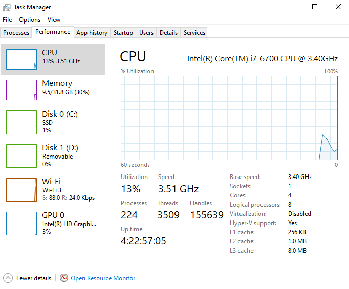

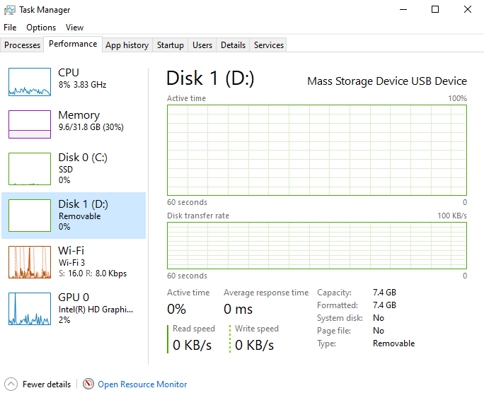

Hello, I am looking to upgrade my graphics card on my HP z240 sff. I have a PNY GTX 750ti and I was wondering if it would work with my PC or if I need to upgrade my power supply. The pictures attached are my specs. (the "mass storage device" is the SD card for my Ender 3

Okay, I will see if it works well and if it doesn't work well I will upgrade the psu as well. Thank you for your help!
