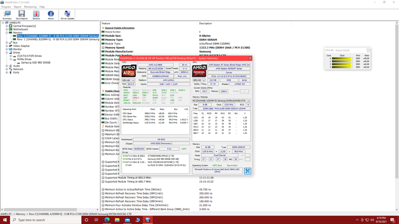

Hi Paul, it's me again!  Well, I ran the HWINFO64 app.  Your suspicions were as always "spot on".  The new ram Is in fact DDR4-2666.  I took screenshots ( as best I could ), so you can check the performance. I took two(2) as to show Ram in slot 0, and Ram in bank 1. I hope you can see them well enough to see what you are looking for. Thanks.Screenshot (2).pngScreenshot (3).png
Hi:
Excellent.  The memory is running in dual channel mode and faster than I expected.
It is running at 1197.8 MHz x 2 = 2395.6 (2400 MHz).
I wasn't aware that any AMD 'A' series processor ran the memory at greater than 1866 MHz.
So, everything looks great, according to what I can see on the reports.
