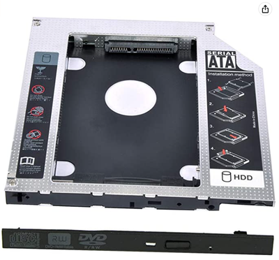

Thirdly, yes, I would get rid of your optical drive (nobody uses this anymore anyway) and replace it with a 9.5mm SATA SSD Caddy Adapter, such as this one: https://www.amazon.com/Universal-Adapter-Enclosure-DVD-ROM-Optical/dp/B07ZHWZ4GD/ref=sr_1_21_sspa?cr..., and use this adapter to fit a SATA 2.5-inch 7mm SSD for additional storage.

"SATA SSD Caddy Adapter" Yes that would be the elegant way to do it, I used the caddies in HP laptops, but in this USDT case the Caddy is to bulky, I would prefer 1.8 Inch Micro SATA HDD SSD to 2.5 Inch sata 22PIN SATA 3 Adapter, either as a Riser card or Cable to the HDD
