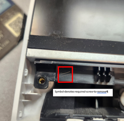

flip the unit over and take off the sound grill. This was very hard to remove but a pry tool works and it is just clipped in. Be sure to be careful because to overlaps the screen so try to stay near the bottom left or right corners so you do not damage the screen.
Once the cover is off now you should see the screws. There are 14 that I counted. They have a symbol that shows the screw is required to be removed.
