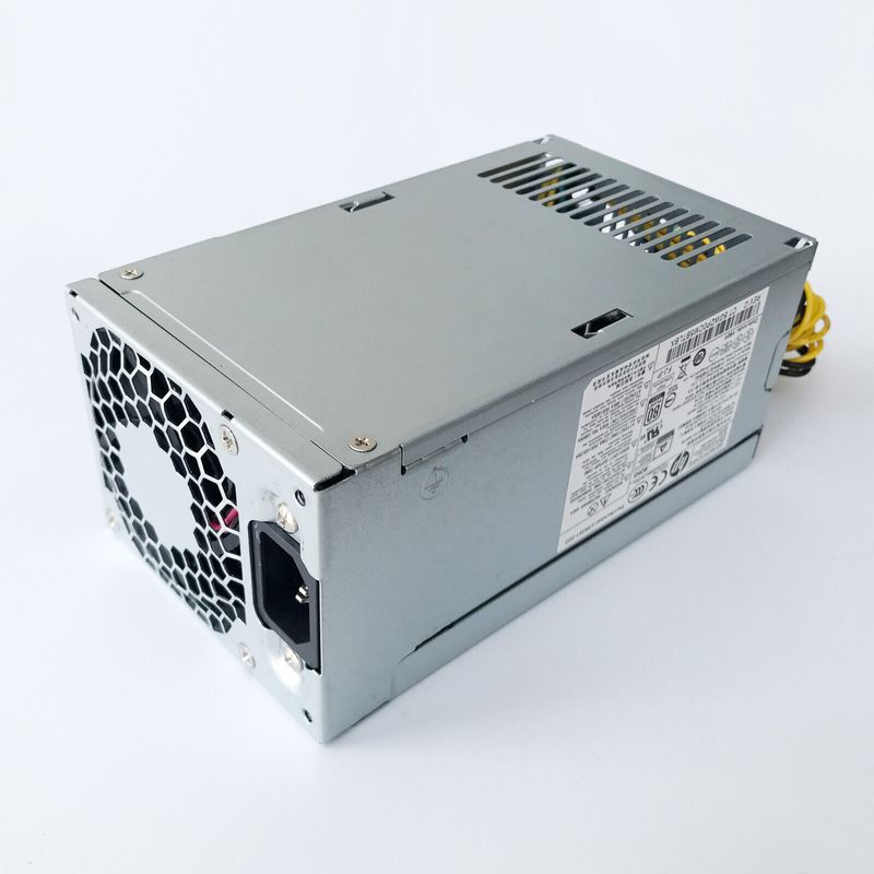

If you have the microtower then the following will fit
936512-001 | Power supply unit 310W EntL SFF Full Range |
https://www.google.com/search?q=936512-001
The motherboard is not a standard ATX and I do not believe you can use a standard ATX power supply
Possibly our expert @NonSequitur777 might know of adapters from a standard atx to your motherboard but I am not sure if the case will take an atx supply

01-21-2024 12:53 AM
Then the part number @BeemerBiker provided for the 310 watt power supply is correct. Like I asked, what graphics card upgrade do you have in mind?
Kind Regards,
NonSequitur777
01-21-2024 01:04 PM
The 310-watt power supply is not easy to locate in the US either, and it is nigh impossible to get technical data on either the 180-watt or the 310-watt power supplies.
So, let's try this.
Please take some close-up pictures of your 180-watt "P2" power connector:
This picture doesn't make it clear to me if this P2 power connector is either a 6-pin or 7-pin, or the exact color positions of the individual power wires.
This will help me to ascertain if there are any other power supplies that could be compatible with your HP 290 G1 MT.
