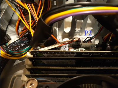

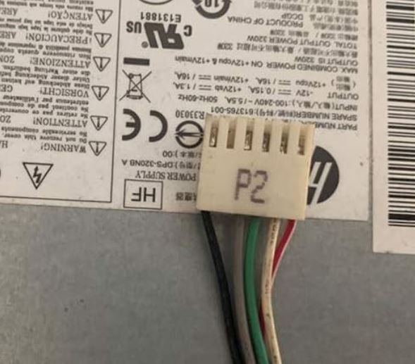

Hi ,so please fine below photos but this is what i have at the moment since i am not at homeconn 3-way.JPGCapture.JPG
I dont have the white and red cables in my connector
@DAVE758,
Most times, different P2 wire color schemes are a lesser issue, or no issue at all.  However, the ATX power adapter wouldn't work for your desktop because your power supply has a 7-pin P2 connector, whereas the ATX power adapter is designed for 6-pin P2 power connectors.

Hi thanks the code I can only find is the L08262-004  and it seems the 310w with same plugs
