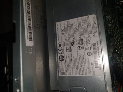

I have an i5 8500, Gtx 1050 ti, 8GB ddr4 2666Mhz RAM but my power supply is only 180w 80+ gold. Somehow it is running and I can run valorant at 300 FPS with it. You're probably thinking that this will end bad eventually with some sort of power shortage however I downloaded Geforce experience and I found my GPU only draws max 50w. I'm not planning on burning my house down so I'm still going to upgrade it.
I have done some research on PSU upgrades and found a thread on this website with the amazing individual tagged above recommending two different models of hp PSU which would match my office PC.
I have found one of these models on eBay. Pictures below. The proprietary 7 pin matches up with my PSU.
The problem here is that the 4 pin power cables are slightly different. Both of the 4 pin's wires on my current 180w PSU are 2 black 2 yellow. On this eBay one there is one 4 pin that has 2 black wires 2 yellow and another 4 pin which is 2 black 2 brown. Will this be fine? Any electrical engineers here to help? I actually want to become an electrical engineer when I'm older so this is good practice lol. Thank you!
Picture of my PSU wires:
My PSU:

Just to reiterate, the problem here is that the 4 pin motherboard power cables of the £25 PSU i've found are slightly different in colour to mine. Both of the 4 pin's wires on my current 180w PSU are 2 black 2 yellow. On this eBay listing below there is one 4 pin that has 2 black wires 2 yellow and another 4 pin which is 2 black 2 brown.
the 4 pin cable at the front has 2 brown wires
From my research and limited knowledge, this chart might help to understand the problem slightly further
Of course, if you happened to know anyone with expertise in this subject of electrical wiring and were able to redirect them here then that would be greatly appreciated. From what I can tell, the brown wire might have a lower voltage so I don't know if that will damage the motherboard.
As for the mention of a 400w PSU, I have looked around and not been able to find one for a good price (around £25 like the 310w PSU I found). This will have to be a future upgrade for when I'm rich and famous haha. The idea of upgrading my little office PC like some used car definitely excites me!
find the PSU i'm planning to buy here: HP 600 800 G3 G4 310W Power Supply Unit DPS-310AB-1 A 901772-003 | eBay
Kind regards,
Soap

04-26-2024 09:17 AM
Yea, different 4-pins power supply wire coloring. Not entirely consistent across the board, by the way. Based on my personal -anecdotal- experience regarding this topic, I wouldn't worry about that too much. HP has configured its power connectors in such a way, that the individual power supply connectors will only fit where they are supposed to fit (CPU power, motherboard/SATA power, and the "P2" power connector).
In a nutshell, the 310-watt power supply will either work or it will not. In my experience, these were the only outcomes -yea, I don't want to jinx that yet: no spectacular electrical discharges or smoke and such. Look, I'm not going to obfuscate on you: there is always a risk when you "try out" a different HP power supply. When you hook it up, just pay very close attention what happens when you power it up. Chances are you're going to be fine.

05-05-2024 12:17 PM - edited 05-05-2024 12:19 PM
I have successfully purchased and installed the 310W power supply found here: HP 280 285 G3 MT 310W Power Supply Unit 901772-004 | eBay
It fits perfectly and is working with my GTX 1050ti. The brown wires don't seem to be a problem and powers the CPU fine. The only difference I could notice was that the brown wires are slightly thinner at 18 AWG compared to yellow wires at 20 AWG. I suspect that I could even upgrade to a 1650 and i7-8700 and it would be fine since this configuration worked with the 180W 80+ gold PSU. to the person who bought the PSU i linked for £20, I hope you enjoy it. this PSU cost me £38.
Temps look fine as CPU hasn't gone over 60 Celsius and GPU is even cooler at around 50 degrees celsius. PSU makes slight buzzing noise when PC is in sleep mode and I got one blue screen but i'm guessing that's because I was messing with my valorant settings.
Finally, I would like to thank @NonSequitur777 (still don't know how to tag people properly) for all the assistance and suggestions for PSU models.
