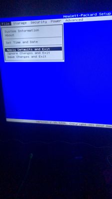

It unfortunately won’t let me take a video, if there is a way to please let me know but it freezes here (1st picture) the second picture I tried booting up at BIOS and it gets stuck here after I try to navigate for a few
it won’t let me upload pictures so I had to upload on “imgbb”
img 1 ) https://ibb.co/rvC59PP • stuck on HP startup / freezes
img 2 ) https://ibb.co/g4yWnfs • freezes when navigating on BIOS
extra ) when going frame by frame during a video I did I did notice some words but I couldn’t get it all due to it saying “attempting windows repair” and it’s also freezing during that since I have the GPU hooked up.
but here is that image but it’s hard to make out
https://ibb.co/kx18ZF5
if you can find me a way to upload a video from my iOS device it would be very appreciated and I respect you a lot for helping me try to solve this @TheOldMan you’re a real one.

 This is when it freezes on startup that I mentioned.
 When freezing during navigation to bios
this below image is when I first started up when I first plugged in the GPU now it won’t pop up it tries to do the windows repair but it freezes as well.
When I remove the gpu it runs normally.
I tried to upload a video but it doesn’t allow me here, it just tells me gif and picture extensions when I converted .mov to .mp4. I’ll possibly upload it on YouTube if I’m allowed to do it that way.
 here is the gif of the boot up though unfortunately it’s in 240p
