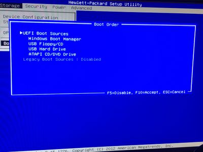

I went to BIOs and went to boot order and completely disabled Legacy boot and activated UEFI Boot Sources. But sadly it’s still freezing starting up.
 I also have Legacy Support Disabled and Secure Boot Disabled.

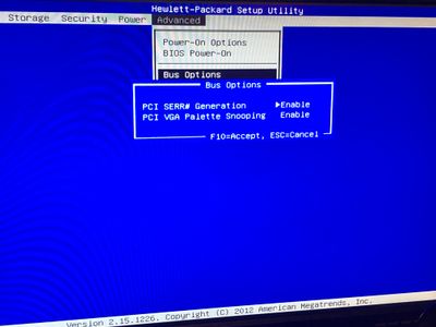

I did notice my PCI Bus options are both enabled, you think that would be the problem?
I would leave the UEFI Boot  Enabled and Legacy Disabled.  Fast boot enabled.
I have no idea what the PCI SERR# Generation or PCI VGA Palette Snooping are for, so cannot advise on them.
