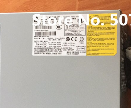

Hello im going to get a new power supply for my z420 workstation and i have a doubt:
searching on google ive seen for sale power supply units with 2 different labels the first with the 80 plus BRONZE logo and the another without the logo, the model for both is DPS 600UB A, in the hp z420 spare part page the power suply part number is 632911-001 and the description is  "Power supply - Rated at 600 W, 90% efficient rating", so:
1.- is the power supply unit without the 80 plus label  better than the power supply with 80 plus bronze certification (90% efficiency is more than the 80% efficiency  of the 80 plus bronze certification)? correct me if im wrong.
