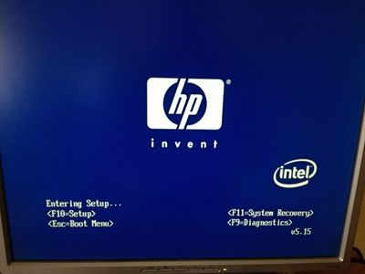

At this point I took another 160 GB HD and I decided to see if the system recognized it in the BIOS, the absurd thing that the motherboard has detected the second HD 160 GB, I started another installation of windows 7 on this HD and now I remain stuck the pc on this home screen:
PC ignition
Also pressing F10 to enter the BIOS remains locked, if I do not press anything the following screen appears:
Without pressing anythingFollowing this screen appears Insert Boot Device etc, there is no moral way to boot any disk on this motherboard, it is possible that the BIOS is corrupt in some way?

N.B: with the 160 GB hard drive, even if I do not press anything, the PC is always blocked at the initial blue screen of the HP.
The BIOS is trying to detect the disk-drive(s), but the disk-drive is not responding to the motherboard, and so you are "stuck" on the "Entering BIOS Setup" screen, waiting & waiting & waiting. Sigh.
