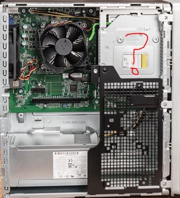

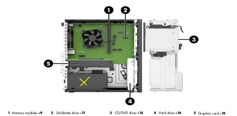

BINGO found real photos in GOOGLE using super careful search  HP Pavilion TP01 below. (tricky to find real photos)
first is real then 2nd is HP manual (photoshop lame). ok DVD top right
and the below HDD 1TB cage (missing?) see why I LOOK FIRST and leap 2nd? looking costs nothing.
X yellow is fake HP PSU. not how HP fails to even mention it exits much less now to remove it. (its stealthy)
to be sure I could put a HDD or SSD there, even if I had to buy a new cage, for sure and will work for sure.
non ATX SPEC, PSU. X
