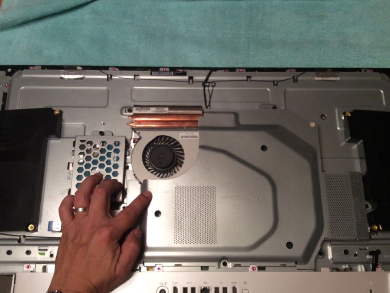

I finally figuered oit how to disable the touchscreen. Once you take off the back cover, there is a small connector with black taoe on it. The board is labled usb. It is just below the cou cooling fan. Disconnect it and that is it. Its the main connector for the digitizer board. Disabling the driver is not sufficient enough. I could care less about the touchscreen. Mine was defective like all the rest out there, but not broken.
I was so frustrated with dealing with the ghost touches.  None of the googled answers worked for me. I finally saw this little entry and I chanced it and excuted the instructions by Racer X for his P014, even though I have a P021.  His instructions were sparse but I tried it anyway WITH GREAT SUCCESS!  So now I have documented this with photos in hopes to help other who have this problem.  It was so easy after all the time I spent trying all the other "solutions". So far, I have not had any issues.
This is a permaent solution to disable the touch screen on an HP Envy 27" P021.
Take 2 rubber covers off at bottom.  For the P021, there is ONLY 2 screws locking the back cover on. (Other black hole is ear phone jack.)Take 2 rubber covers off at bottom. For the P021, there is ONLY 2 screws locking the back cover on. (Other black hole is ear phone jack.)Slide cover towards topabout 1/2 inch and cover should lift right off.Slide cover towards topabout 1/2 inch and cover should lift right off.Close up of inside corner.Close up of inside corner.Take this shield off.  Finger is pointing where the plug is.Take this shield off. Finger is pointing where the plug is.Pointing at plugPointing at plugRemove this plug, circuit board label says TP USBRemove this plug, circuit board label says TP USB
Easy peazy.  Just do everything in reverse , except the TP USB plug-DUH, and you're good to go!!  Hope this helps.
