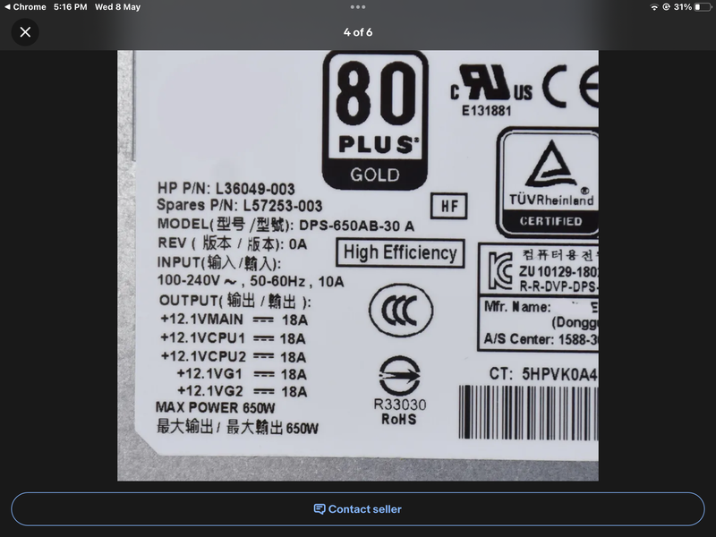

My question is I found 2 hp z2 g4 power supplies but one has 3 4 pins power connectors but the other one has 2 4 pins so I don’t know which one is compatible with my motherboard  my mobo only has 2 4 pin connections so I don’t know why there is a extra 4 pin on the eBay power supplyAE337F75-D4CD-41BC-BA14-F6357FA0EDB7.png2B15FF98-5DF2-4A14-8C68-843F5256842A.jpegB1C203C8-5DFC-4E03-A8FE-A780AE5CE69C.png

Could you confirm this is the right p/n number for the power supply6521292E-0DEB-4339-B570-F34BAC26204B.png

Yes, @Daniel358, I can confirm, again, that you are referencing the correct power supply upgrade for your HP Z2 Tower G4 Workstation.
