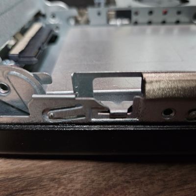

Could you post a picture of your motherboard showing this (with the M.2 NVMe SSDs installed):
Kind Regards,
NonSequitur777
First, thank you for your kindness.
top view. 
a side view. (It's a bit high, right?)
It's a bit up.
I think we need some space at the top of the nvme ssd due to the bending of the substrate board and the heating problem of the chipset.

Thanks to you, I found out one more thing, the height of the hard disk on my mini desktop was 9.5mm.
However, even if the hard disk was removed from the cage, the top of the chipset of the second nvme ssd touched the bottom of the hard disk cage.
Oops. OMG.
I don't want to conclude so tentatively because I will continue to love HP's design method.
Because the second nvme ssd has a larger capacity, I will migrate the first nvme ssd to the second and then leave the second slot blank.
Thank you for your kindness until the very end.
