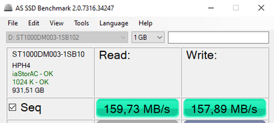

Hi,
I just wanted to know if my motherboard can handle the speed of an SSD in SATA III.
Because I pluged an SSD Crucial MX500 1 To in one of the SATA port but when I checked his speed it doesn't go higher than 130 mb/s.
I also checked the type of SATA and it says SATA 1 which is weird because my old HDD is in SATA 3.
I tried to switch the port between SSD and HDD but it doens't change anything.
My computer : OMEN by HP 875-1000 Obelisk Desktop PC (6VL65EA)
Thank you for reading, I hope you can awnser me !

12-06-2021 07:56 AM
That software seems to be reliable based on the comments I saw.
According to the specs for the model you posted, it is supposed to also have a M2 drive (SSD 256 Go PCIe NVMe M.2) installed. Does the AS SSD Benchmark software see that drive, also? What are the speeds for that drive?
