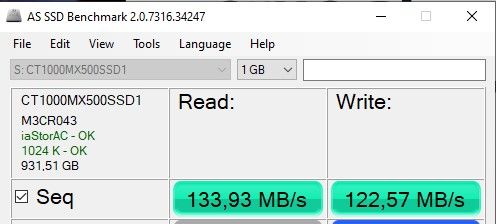

In order to measure the speed I used the software AS SSD Benchmark with 1GB of transfer :Capture d’écran 2021-12-06 152141.jpg

That software seems to be reliable based on the comments I saw.
