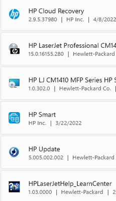

get rid of procinfo (app name is touchpoint)
https://www.computerworld.com/article/3238512/hp-stealthily-installs-new-spyware-called-hp-touchpoin...
put "add or remove" into the windows search and look for applications that start with
HP
HPE
Touchpoint analytics
the following are all OK, do not delete
Possibly your antivirus removed it but did not do a good job of getting rid of all of it.
