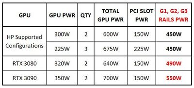

As mentioned in the title, will the HP Z840 (with 1125w psu @ 220v) handle 2x 3080 OR 2x 3090? What about the NVlink for the 3090s, would it be supported?

There are 2 potential problem areas with the newer high-end 3000 series RTX cards, based on various youtube videos I've seen. The first issue is power, since the 3080 is a 320W card, and the 3090 can draw upto 350W!!! The second issue is the physical size of these newer RTX cards, especially the 3-slot width 3090 card standing at 5.4" (138mm) tall which I doubt would fit in the Z840 chassis. So I would definitely avoid the 3090 card with regards to the Z840, mainly due to its physical size and power requirements. Since you're GPU rendering, (see our previous post), NVLink/SLI support is not needed. This leaves the 3080 card as a possible option, (which doesn't appear to have NVLink/SLI anyway). Also, don't forget that you have a 1450W PSU since you are on a 220v supply.
Please bear in mind that this is unchartered territory, so I'll just stick with my electrical knowledge for guidance.
1. For 1x RTX 3080 card, I would connect power from the G1 and G2 connectors, (using good quality 6-pin to 8-pin adapters).
2. For 2x RTX 3080 cards, I would connect G1 to GPU 1 and G3 to GPU 2, (using good quality 6-pin to 8-pin adapters), connect G2 to both GPU's using a 6-pin to dual 8-pin splitter as discussed in our last post.
As I said, this is simply my best guess, so I can't guarantee success. Good Luck! Let me know how it goes.
