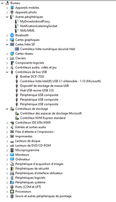

I had a doubt, and search next, because I don't have that, found little information, but nothing to do with the sd card
but so you tried to disconnect the card reader?

I took the risk and updated the BIOS to F.48 successfully
The SD card reader appears as a Disk as Generic SD02G SD card ( Dispositif de stockage numérique sécurisé )  and I can read what is on the SD card
I don't understand exactly how its works but it works
Thank you very much for helping me
