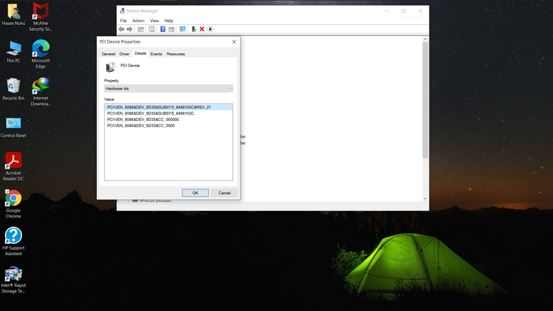

I have a laptop HP Pavilion x360. On device manager under other devices the PCI's and unknown devices shows that drivers are missing, when i try to update them it says drivers are not installed.
Attached are some screen shots that i hope will be useful.
I have a Windows 10 Home 64 bit.
Please can someone help me find the right drivers for these devices?

As regard to the PCI's there was an error after each of them finished installing.Error for PCI DevicesError for PCI Devices

Try this driver for the 9D27 (the first screenshot...
https://ftp.hp.com/pub/softpaq/sp100001-100500/sp100187.exe
For the PCI device try manually installing the driver as follows...
Go to the device manager.  Click on the PCI device needing the driver.
Click on the driver tab.  Click on Update driver.
Select the 'Browse my computer for drivers' option, and browse to the driver folder that was created when you ran the file.
That folder will be located in C:\SWSetup\sp100139.
Make sure the Include  subfolders box is checked and see if the driver installs that way.
Here is a partial copy and paste of the driver setup information file which shows driver support for that hardware ID...
[Intel.NTamd64.6.1]
; DisplayName Section DeviceId
%TEE_DeviceDesc%=TEE_DDI, PCI\VEN_8086&DEV_9D35 ;SKL, KBL U/Y/R; AML
%TEE_DeviceDesc%=TEE_DDI, PCI\VEN_8086&DEV_A135 ;SKL, KBL H
Then do the same thing for the PCI Simple Comms Controller but browse to C:\SWSetup\sp110054.

The only device left is the PCI Data Acquisition, it's proven stubborn 😁HP System InformationHP System InformationPCI Data Acquisition folderPCI Data Acquisition folder anyway i think you forgot to include the manual installation folder for me, because the manual install was what resolved the other two.

If you want to try manually installing the driver for the very stubborn PCI Data Acquisition device, you browse to C:\SWsetup\sp100093.
