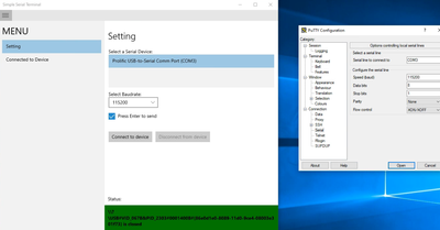

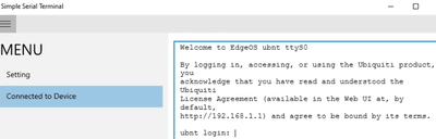

There is something wrong with Putty even 0.77  It beeps trying to connect to the console of my EdgeRouter but Microsoft's Simple Serial Terminal works fine***

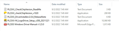

*** the default Prolific drivers that came with windows needed to be upgraded.  I had to run the chip finder then the driver install
I have no idea why putty did not work.  That SST app (from M$oft store) went and found the device whereas Putty had to be told t use com3
Thanks, the chip finder wouldn't open the adapter.  I ran it on my Windows 11 notebook and did find the right driver for the PC2303GC chip set.  I installed that driver, and still it would not work.  Also, my PCIe bus serial board has the same problem,  I can no longer open COM2 (or any other COM port set in device manager) from Putty or SecureCRT.  The IOGEAR USB-serial cable works fine in my Win7 (HP) WIn11 (Lenovo) laptops.  The Vantec PCIe serial card works great in my Win7 HP tower.  Neither will work on my HP Envy Win10 tower.  I even went into the registry and cleared the ComNames entry.  I unplugged all USB devices and plugged in the IOGEAR USB/Serial adapter by itself and it still won't work.  Perhaps a Microsoft Update or a security setting is preventing these two fundamental devices from connecting.  All other USB devices work great.   APC PowerChute, Brother Label Printer, Startech USB FaxModem, to name a few.  I cannot get any RS232 serial port device to work - USB IOGEAR or TrendNet - nor a real PCIe bus connected serial card.  Strange....
Did you try Microsoft's Simple Serial Terminal?  Putty serial no longer works on my Win11 or Win10 systems
SSH and Telnet work fine, just serial does not find the com3 device, only SST
https://apps.microsoft.com/store/detail/sst-simple-serial-terminal/9P6M6GJSF3HN?hl=en-us&gl=us

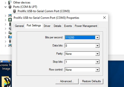

1 You may need to configure the baud rate using the device manager

Thanks, I did set the baud to 9600 to match the management port on the device.   I still have the same problem.  It takes several reboots and some quick action to open the COM5 port with SercureCRT or Putty to open the device.  It's odd, same setup works perfectly every single time with my old Win7 Laptop or a brand new Lenovo Win11 laptop.  This HP Z1 tower works fine with other USB/Serial devices including:
