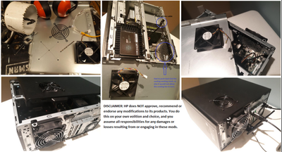

Your HP Z2 G5 SFF is very similar in nature with my HP EliteDesk 800 G5 SFF upgrade project:
Based on your current setup, I would suggest adding two cooling fans to your case: one on top of your upper desk panel just above the CPU heatsink cooler air intake fan blowing air down (in) your case, and one cooling fan externally on the back panel, assisting the CPU heatsink cooling fan blowing air out your case:
[EDIT:] You'll have to ascertain what size () cooling fans (70mm/80mm/90mm) is/are the best fit for your case.
Each case is different.  For example, here is my HP ProDesk 600 G3 (later G4) MT upgrade project:
Depending on if your motherboard has a secondary PWM 4-pin cooling fan connector, you can power these two additional cooling fans using a 1-to-2 PWM splitter cable, or if absent, use a 1-to-3 PWM splitter cable using your CPU PWM 4-pin cooling fan connector.

First, your HP Z2 G5 SFF motherboard, in addition to the "CPUFAN" 4-pin PWM connector, has two additional PWM 4-pin fan connectors, labelled "CHFAN[1]" and "CHFAN2":
This is very good, because you are correct: you definitely need extra air going in your case given your GPU temps.
I'd suggest installing a third cooling fan (#3) to provide air (blowing down) for your graphics card dual fan intake on top of your case:
Yea, this is sort of a pain, but it will make a significant difference!  If you go this path, please be careful.  Know what you are doing. Use PPE such as safety glasses.
