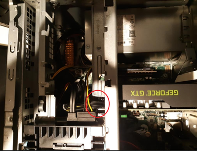

The Dell Nvidia GeForce GTX 1660 Ti 6GB GDDR6 came in.  I uninstalled the AMD drivers first, shutdown the PC, removed the RX 5500 and replaced it with the GTX 1660 Ti.  Downloaded the Nvidia driver for the GTX 1660 Ti from here: GeForce Game Ready Driver | 527.37 | Windows 11 | NVIDIA, and successfully installed this graphics card.
Side Note: because the 8-pin PCIe power connection for this GTX 1660 Ti card is situated on its rear-top corner, I had to 'modify': i.e. cut a section out of the desktop's drives bay insert -see red circle, in order for the drives bay to fit.

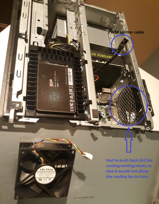

The: let's addon-an-additional-cooling-fan operation succeeded.
Had to change my initial plan though.  After careful measurements, it became crystal clear that the HP ProDesk 600 G3 MT's drives cage would not allow a 90mm (9025) fan to be installed on the inside of the chassis.
However, an 80mm (8025) fan would just fit -that is, I had to move the stock secondary 9025 fan from the inside to the outside of the chassis, in order to allow the installation of the 8025 fan (allowing moving the top panel off and onto the desktop) -see pictures:
Using off-the-shelf (well-used) work shed tools.  SAFETY first and foremost.  Always.  No shortcuts.  Ever.
DISCLAIMER: HP does NOT approve, recommend or endorse any modifications to its products. You do this on your own volition and choice, and you assume all responsibilities for any damages or losses resulting from or engaging in these mods.
The 8025 fan happily follows suit and revs up when the primary and secondary cooling fans speed up.
Will do/run some testing/stressing to see how much difference in CPU temps it will make.

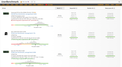

Ran the UserBenchMark performance test again (HP ProDesk 600 G3 MT Performance Results - UserBenchmark), with the hope that my benchmark would show up here: UserBenchmark: HP ProDesk 600 G3 MT Compatible Components.
Unfortunately, my score does not show up again, for reasons unbeknownst to me.  In any regard, this rig works and performs very well, as these benchmark results show:
And this desktop should be #1 in UserBenchMark's HP ProDesk 600 G3 MT category.

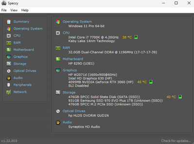

And there you have it: UPS, Inc. was so kind to deliver the new (pulled from a brand-new HP desktop) HP Nvidia GeForce RTX 3060 12GB GDDR6 early.
Installed, optimized graphics performance (no kidding, see below!) and kicking -well, out of the park.
Link: https://www.userbenchmark.com/UserRun/57351752.
And showing up immediately in UserBenchMark as the #1 HP ProDesk 600 G3 MT:
Link: https://www.userbenchmark.com/System/HP-ProDesk-600-G3-MT/54133.
