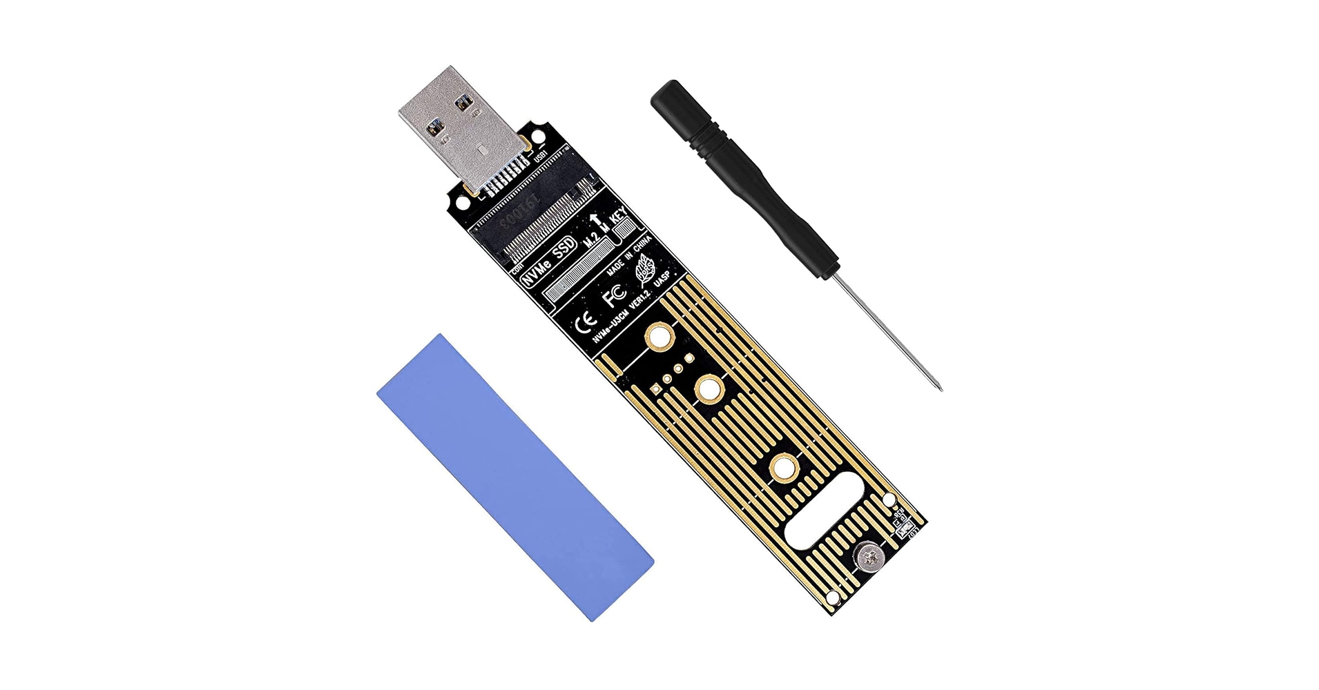

Do you want to upgrade your M.2 Solid State Drive (SSD) but think it is too hard. Think again. In this video tutorial we show just how easy it is clone your M.2 SSD using a cheap USB adaptor and free disk cloning software from Macrium Reflect. This video answers the following questions: How to ...
