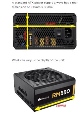

I found this on the corsair website. https://www.corsair.com/ca/it/blog/how-to-build-a-pc---the-power-supply
Hopefully that helps
Edit: here is a screenshot of what I was reading
@dhboone,
As explained, your existing PSU has a depth of 5.5".  Your choice of the RM650 has a depth of 6.3".
Per NewEgg (3.39" x 5.91" x 6.30"). on the Corsair RM650, and Corsair spec page does list the dimensions (
Dimensions 150mm x 86mm x 160mm) , as shown here.
So, in all honesty, as I said, It has the latch, so the RM650 will not latch-up.
Step 13
Push the power supply release latch on the side chassis and gently pull the power supply out of the chassis.

Ok. Thanks.  As I mentioned earlier, the Cosair and NewEgg photos don't make it clear which dimension is which because they leave off the H, W, and D in the dimension specifications (3.39" x 5.91" x 6.30").  For clarity, the H, W, or D should always be shown behind each figure to specify which number is which. Also, line drawings on the photo would help too.
