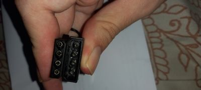

I also bought another cooler the Hyper h410r and I found out that it brings a mini control and could you help me locate where this piece would go? The manufacturer says it is connected to the power supply but I don't know what pin or pins I should use. The model of the control is WIRED RGB CONTROLLER C10L and says it is 12v, 4 pins, 2A and I attach a picture of the mini control.
Hi @Pacopjds
Good to see the M.2 drive has improved performance.
The image looks like you holding a 4 pin 12v RGB connector to the MB and a Molex power connector to the power supply.
I don't think your MB has any 4 pin 12v RGB headers. I would not know if the power supply has Molex connectors.
Maybe the 4 pin 12v cable from the fan can connect to the RGB controller when the MB does not have a 4 pin RGB header. You might then need a Molex to SATA power adapter from the RGB controller to the power supply to provide power to use the fan's RGB function.
