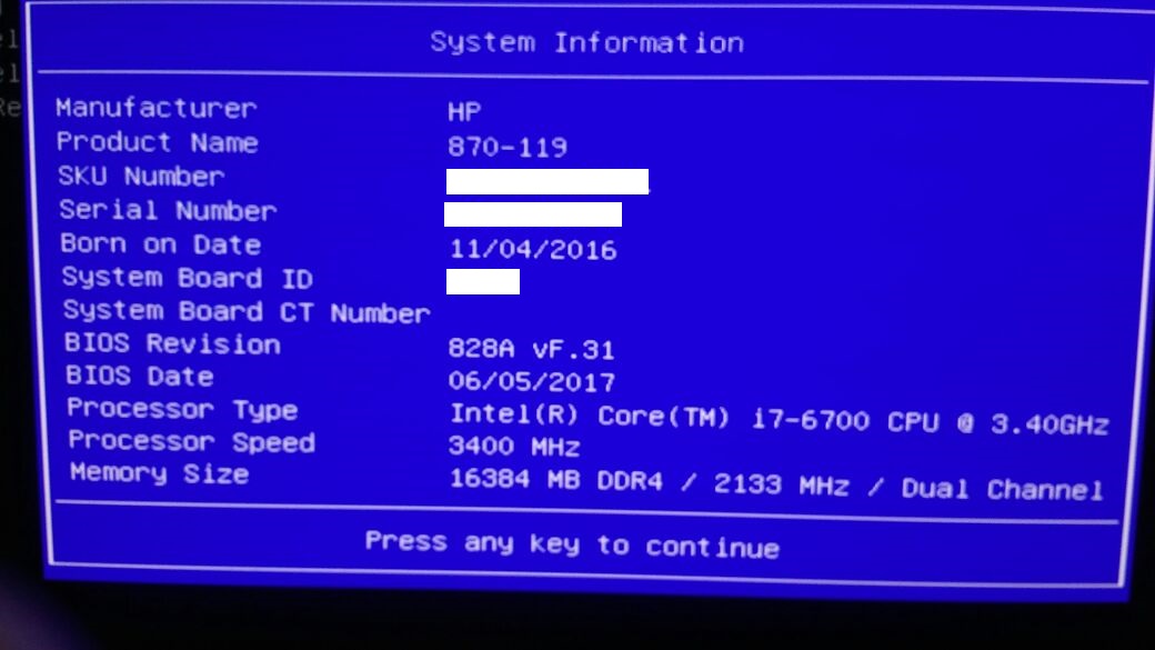

Hi there,
               i given this system in hp for warranty. and they might have changed the motherboard.
after it was working fine.   but since last few days i am facing this error message, when i start the computer.
so again i contact hp  they said now warranty has finished already.
           as you can see in the picture there is no CT Number showing here.
so where did i find out the CT number ????

Hi there,
so where did i find out the CT number ????e266eb21-6556-4c85-945f-4ae2e3946447.jpg
