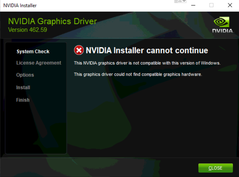

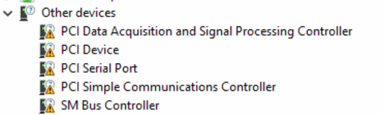

I have turned off secure boot in the BIOS. I have tried with legacy devices enabled and disabled. The Wi-Fi card works in all PCI-E expansion slots. The graphics card still fails to register at all. Driver failed to find the hardware.Driver failed to find the hardware.This shows up in Device ManagerThis shows up in Device ManagerNo drivers installed, just Microsoft Default.No drivers installed, just Microsoft Default.
@CAS97,
Of course, you got the latest version of Windows.  Do you mind trying to install your RTX A2000 using this Nvidia driver version: https://www.nvidia.com/content/DriverDownloads/confirmation.php?url=/Windows/Quadro_Certified/462.59....
Kind Regards,
NonSequitur777
It is the most up to date version of Windows 10, and these drivers fail as well to install. The only thing interesting I did this time is I had the graphics card hooked up to HDMI and got Teamviewer connected while it was like that. It took a few tries, but in device manager there are fewer PCI devices showing up because of this method. Screenshot 2023-04-11 062134.png
