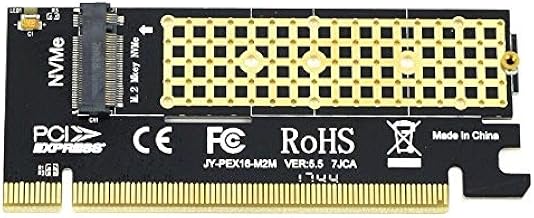

I use SATA 3 M.2 SSD and put them on a PCIe x16 adapter because it is so much less hassle and makes for a nice clean installation.
The adapters are inexpensive. See the hyperlink below this line for a source.

That would mean that your best bet would be to use a PCIe adapter for a SATA3 SSD and put it in an available PCIe slot.

Ah, now that is interesting; I shall definitely try that. Thank you for drawing that to my attention otherwise I would not have known.
