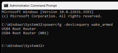

Run the following command from the windows administrators command prompt
powercfg -devicequery wake_armed
for example the following devices are enabled even if the PC is turned off
They are all drawing power EVEN WHEN LAPTOP IS TURNED OFF.
You can disable these devices using the device manager as explained in step 1 here
