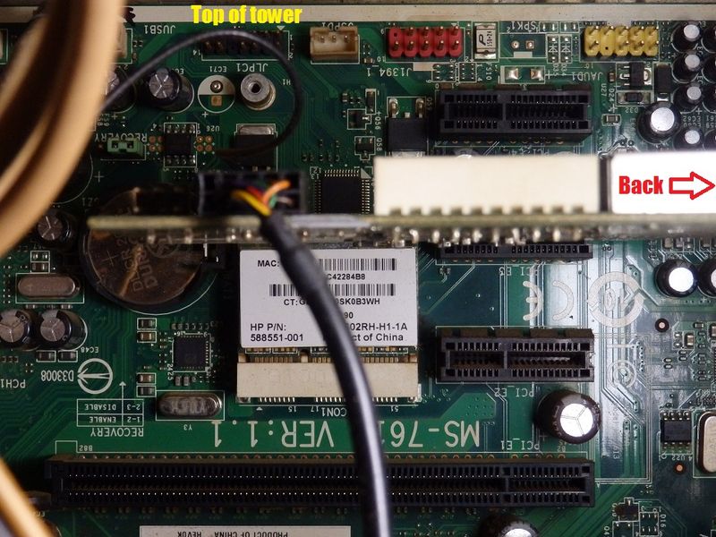

I have a total of 4 PCIe slots & only 1 is used. I opened the case & took some pics (See attachments).
Can you recommend some cards & the best slot to use ? I'm thinking 1 of the small ones.
Thanks again !
P.S. How do you give a Thumbs Up ?
04-04-2022 04:36 PM - edited 04-04-2022 04:37 PM
You're very welcome.
Yes, you would want to install the PCie x1 card in one of the small slots.
All of the PCie x slots are gen 2.0.
This one has 4 ports for example.
The longer one is for a graphics card if you ever wanted to add one.
