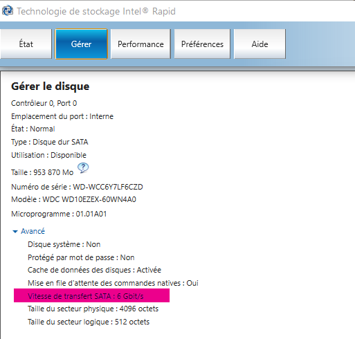

Thankyou for responding and telling me that. I’m also looking at a ssd to replace my hdd would I be able to easily just swap them out? And also if I wanted a ryzen 3 could I buy another motherboard? Would the ram still work in it? Would that work?
And also do you know how fast my hdd is? And what ssd I should get? Could I use a ssd as main boot drive and hdd for storage (I know how to configure it) I just need to know would that be possible in that motherboard orchid 3.
No, replacing the motherboard may be impossible, or very complicated!
to replace the SSD, you have to open the pc to check if there is a location to place it, or if not the choice to remove the original disc!
For the model, you have to try sites with Scan like this:
Welcome to Crucial USA
There are practically all the answers in the links given
Rotational Speed: 5400 RPM
unless the request is if it is sata 3 or other?
The pc is quite new, there is probably at least a sata 6, but I can not say it, I have not read this information!
We can check it simply, with intel storage, the speed is indicated here:
Upgrading and Servicing Guide
https://support.hp.com/us-en/product/hp-pavilion-550-100-desktop-pc-series/8499648/model/9329705/doc...
If it is possible to place both yes, this is not a problem.
There are three sata ports on the motherboard
So at least one free ( not use )
