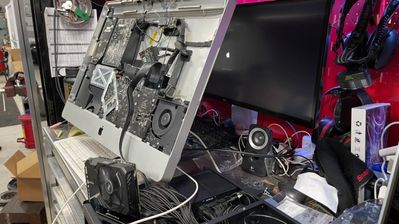

Received the x8 adapter in the mail today. It does indeed have a x16 slot. I’ll have to wait till Monday to try it out in the iMac. I’m assuming the 20pin connector is the same as the psu 20pin?
Outstanding!  -Please provide a picture if you don't mind.  Yes, the MXM 3.0 to PCIe X8/X16 dock's 24-pin power connector fits on any standard ATX 24-pin power supply.
Come Monday I will post some pictures.
Started playing with it this morning with some promising results. I’ll need to reinstall macOS for it to fully boot as right now it was setup for the nvidia k1100m. It did boot into the windows 10 though. Not sure all the differences between the x16 and x8 but the x8 has a 20 pin connector instead of 24. The 24pin connector from the psu still fits and works as it should. My end game for the iMac is to fit my low profile rx560 powered by a pico psu inside the iMac along with the lcd driver board and have it all self contained. I’m the meantime though, I do want to play with the gtx 1060 6g I have in windows and see how it does for gaming.
