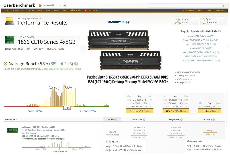

The last two Patriot Viper 3 8GB RAM sticks arrived and installed. Ran extensive RAM tests and all passed A-OK.
The RAM scores were very decent for DDR3 memory: please see the PassMark PerformanceTest scores for RAM & Memory Read Uncached, especially considering that this RAM 'competes' with DDR4 memory. The UserBenchMark RAM test results were almost identical.
Patriot Viper 32GB RAM_211119.jpgPassMark Rating HP Pro 6300 SFF_RAM_211119.jpgPassMark Rating HP Pro 6300 SFF_MemReadUncached_211119.jpg
This RAM continue to hold steady and performs solidly "above average", doing well for DDR3 RAM with gaming in mind.
