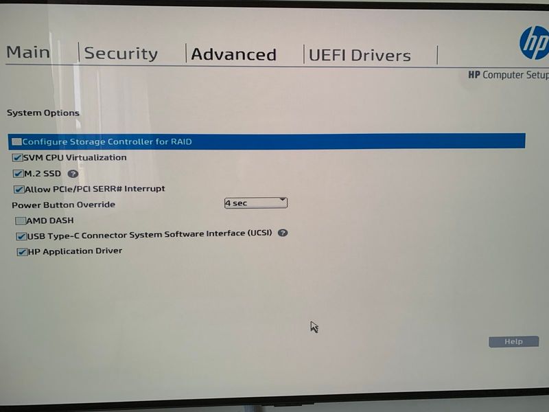

11-30-2024 04:47 AM
Thank you for your reply!
I've checked the card on another computer and it is working perfectly fine. I doubt the issue is with power supplier as everything is working fine. I also wasn't able to find any related settings in bios, just in case attaching photos for your review. I found another, similar conversation on HP forum - sadly without any resolution. https://h30434.www3.hp.com/t5/Desktop-Hardware-and-Upgrade-Questions/upgrade-EliteDesk-705-G5-Small-...

11-30-2024 12:00 PM
As you showed with an earlier related discussion thread, it is unclear why some Users encounter zero issues powering an RX 6400 with a stock 180-watt power supply, whereas others, like you, have a different experience...
Anyway, did you check the BIOS Advanced tab's "Built-in Device Options" and "Port Options"?

11-30-2024 01:19 PM
I wonder if this is not related to different processor/motherboard. Any way, I've already sent picture of Built-in Device Options in my last post, and I'm attaching port options in this post. I can't see anything what could be related to the issue but if you think any of this setting may be related - please let me know so I will test it.
