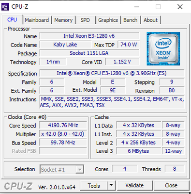

Upgrading a legacy HP desktop is rewarding -at least it is to yours truly.  After 99.8% completion of my "Upgrading HP EliteDesk 800 G3 SFF" project, I ended up with plenty of unused computer parts, such as a Xeon E3-1280 v6 (3.90 GHz to max 4.20 GHz) processor, decent DDR4 RAM and one Western Digital 1TB "WD Blue SN570 NVMe - Gen3 x4 PCIe 8Gb/s, M.2 2280, Up to 3,500 MB/s - WDS100T3B0C" SSD.
I wanted to find a 'fitting' destination for these PC components.

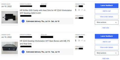

And what do you know: eBay Sellers happen to offer so-called "bare-bone" HP Z240 Desktop Workstation SFF's at amazingly low prices, starting at $45 [07/10/2022].
This desktop can be fitted with a Xeon E3-1280 v6 -see: UserBenchmark: HP Z240 SFF Workstation Compatible Components and this link [yes, I know: "ASRock" -but these specs also apply to the HP Z240 SFF p/n: 837345-601 ("SPS-BD SYS Z240 SFF WIN") motherboard]: CPU-Upgrade: ASRock C236 WS processor support, and has an M.2 NVMe 2280 SSD slot, so why the heck not: I ordered an HP Z240 SFF, including an "HP NVMe SSD Caddy with Heat Sink for HP Z240 Workstation SFF Desktop p/n: 826414-001":

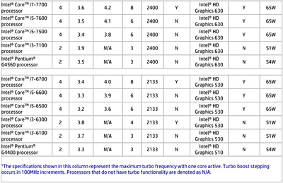

To return for a moment, if I may, to address HP sanctioned processors, according to: https://support.hp.com/us-en/document/c04892038#AbT5, there are but three options:
This HP processor compatibility listing is clearly (very) incomplete.  ALL 6th AND 7th generation Intel and Xeon processors are known to be compatible with this desktop platform. This HP "QuickSpecs" HP Z240 SFF Workstation (pdf: c04762288), archived by cdn.cnet content, is more complete: http://cdn.cnetcontent.com/f3/4c/f34c81d1-92d2-4612-a071-4e290a55eb26.pdf
And even this table is incomplete, as it excludes, for example, the Xeon E3-1280 v6 I am going to install, and the Intel i7-7700K. Other sources do include the i7-7700K, such as this "Build Your Own - Custom HP Z240 SFF Workstation" site: https://pcserverandparts.com/build-your-own-custom-hp-z240-sff-workstation-with-dvd/

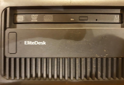

[UPDATE:] Holy mother Flanagan in a side-car snacking on chocolate jimmies with a lobster bib: the Seller mailed me an HP EliteDesk 800 G2 SFF and NOT the HP Z240 Desktop Workstation SFF...
Immediately contacted the Seller: "please advise".

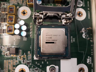

Since the bare-bone HP Z240 SFF Workstation which is en route to my home does not come with a processor, and the intent is to fit it with a Xeon E3-1280 v6 processor which does not have integrated graphics, I purchased one of the least expensive LGA 1151 processors with integrated graphics I could locate that I know to be compatible with the HP Z240 SFF.
The reason for this intermediate processor is that I found out that it is a heck of a lot easier to set up a computer starting from ground-zero with a processor that has integrated graphics, so that you don't unnecessarily complicate things starting out with a non-integrated graphics CPU.
Anyway, this low-cost processor would be an Intel Core i3-6300 (2 cores 4 threads, running at 3.80 GHz) which has the integrated Intel HD Graphics 530, see: https://www.userbenchmark.com/UserRun/49557793, running on BIOS Date 20201215.

First order of business: install intermediate Intel i3-6300 CPU as explained in previous posting.
Apply a quality thermal paste to the processor:

The first benchmark run of the Xeon E3-1280 v6 went very well: 86.5% -even before optimizations which have shown to increase performance:
